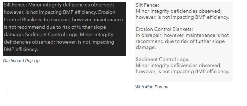

I have a custom Arcade expression being used in a web map for a pop-up and it works fine. When this web map is added to a Dashboard, the expression is only partially recognized. I have a "TextFormatting.NewLine" that is not being recognized. Is there a way to have a return carriage in a Dashboard?

It is my understanding that Arcade expressions are not fully supported in the regular dashboards. ArcGIS Dashboards Beta has support for Arcade. This article has information on the Beta dashboards:
https://community.esri.com/t5/arcgis-dashboards-beta-documents/what-s-new-in-the-arcgis-dashboards-b...
