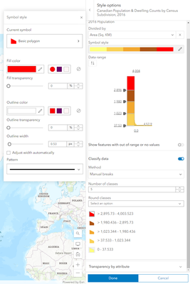

Is it possible to customize the colors in a pre-existing color ramp? Or create a custom color ramp? I need to color population class breaks in different layers to match the same color value in both layers regardless of what the top value is.
RussRoberts
Esri Notable Contributor
You can define the color for classed values by clicking on the color swatch in Map Viewer. We do have plans to support the following but not coming in an upcoming release:
- customizing existing color ramps for other cases like the unclassed
- publishing your own color ramps with web styles

Thank you, I've been trying this, I've seen this response before. It wasn't working at all until I realized that I have to be the owner of the layer. Thanks!
