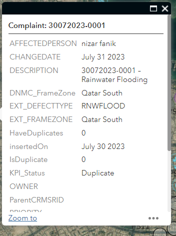

DNMCSCADA
can I customize my web app builder default popup?
