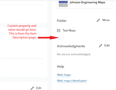

PaulLohr
@XanderBakker - assuming we store the custom property and value in a table, how do we get the information on to the Item Details page? Web Map or item specific information would be useful on the Item Details page.
An example of how a custom property and value might be displayed is shown in the graphic below.
This would be useful for any type of AGOL item.
Thanks for any help.
Paul Lohr
Paul Lohr
Lohr Geospatial Services, Inc.
