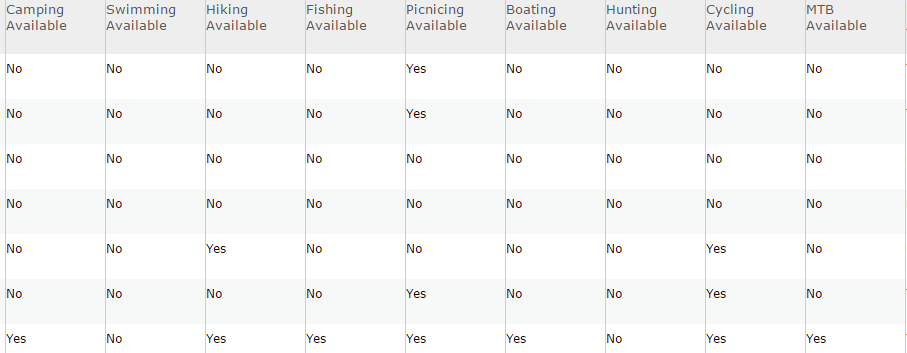

In the ArcGIS online map I would like to customize the pop-ups to show only specific data from the attributes.  The map I am working on shows parks, and in the pop up window i would like to list available amenities in each park. The problem is that in the attribute table each amenity correspond to the specific field, and the values are Yes/No for the amenities (image from attribute included below).
I know what I am trying to do, but I don't know how to accomplish it:
Basically I would like to write the HTML 'if/else' statement in the pop-up, do the following:
example:
if 'Camping Available' = Yes
  return 'Camping'
else
return (nothing)
I would have to do it for each field.
I don't know if anyone has done it with the pop-ups in ArcGIS online, but I would appreciated any suggestions.
