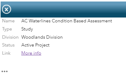

I'm sure there must be a simple explanation for this, but I'm having trouble figuring it out.  I have a hosted web layer containing polygons listing a projects name, type, division, status and a hyperlink to the associated project document.  However, I've been asked to change default displayed "More info" for the hyperlink to something more descriptive.

You'd just replace "$feature.url" with the actual field name, in your case, $feature.link.
Based on your first screenshot, though, it looks like the map is being used in a WebAppBuilder app or the Map Viewer Classic? Those are running on a different JS API, and won't be able to render Arcade popup elements at all.
On the older tools, you're limited to either a single field list, in which the link says "more info", or you have to convert the whole thing to a text element.

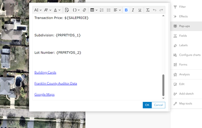

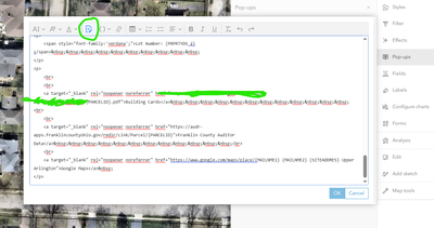

I haven't used Arcade for pop-ups too much, I have used the text field to customize field organization and hyperlink selection. Here are some snippets of what I have accomplished. With these hyperlinks I can give them any name. You can also stack the regular pop-up with a hyperlink text below. I think adding the text pop-up and adding your hyperlink there and going into the source text to manipulate the title would give you a similar outcome.

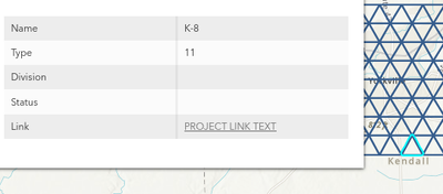

Currently, this is the output I'm getting.  I just need to change the link text, which you know.
This is the current output.This is the current output.

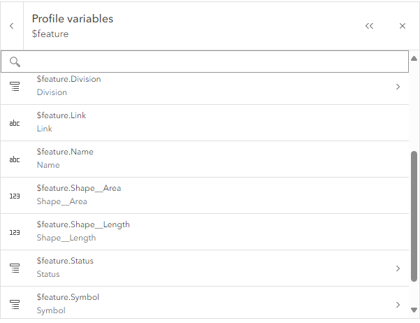

These are the available attributes of the dataset, of which I only need 5.

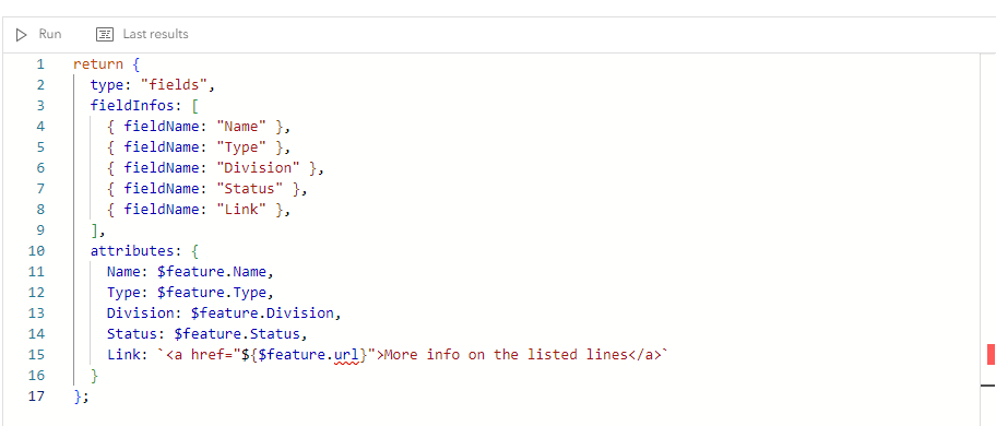

When I sub in the information as you've recommended, I get an error at line 15:
I'm assuming I'm missing some information for $feature.url.  The urls are all listed in the $feature.link.  Do I need to create something new in order to get this to work?  Because subbing $feature.link for the $feature.url isn't working either.  Please advise.  Thanks in advance for your help.
