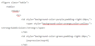

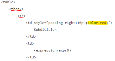

Below are some screenshots from a test:
1) The custom HTML shown in Notepad++ for readability
2) The custom HTML copy/pasted into the pop-up (bracketed in green)

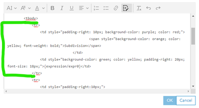

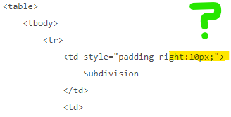

3) If I click OK to accept the pop-up, then go back in to edit the custom HTML, this is what I see, a couple things of note:
  • The table is automatically wrapped in a <figure> element
  • The "color: red" attribute from the first <td> element is missing
  • The "font-weight: bold" attribute has been automatically re-assigned to <strong>
  • The "color: yellow" attribute from the second <td> element is missing
  • The "font-size: 18px" attribute from the second <td> element is missing
by Anonymous User
Not applicable
Thanks @mpboyle - here are answers to your above questions from @LaurenBallantyne :
    • This is expected, since the rich text editor in Map Viewer meets HTML5 standards and conventions. <figure> is used to define self-contained content, and you will most commonly see <figure> wrapped around all tables and images.
    • This is a bug that we’re looking to fix for 10.1, but for now the workaround is to specify the <td> or <th> text color in a <span> tag around the cell value
    • This is expected behavior with the Map Viewer’s text editor. The text will still appear bold with <strong>.
    • Same as the above for style = “color:red” on <td>
    • This is a bug that we’re aiming to address for the next release, just like the color on <td> and <th>. The workaround is also to wrap the <td> or <th> text in <span> and apply the font-size within <span>
