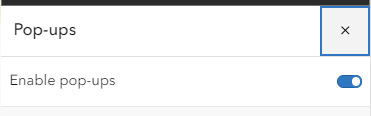

Hi @salexander
Have you enabled pop-ups for the layer?
