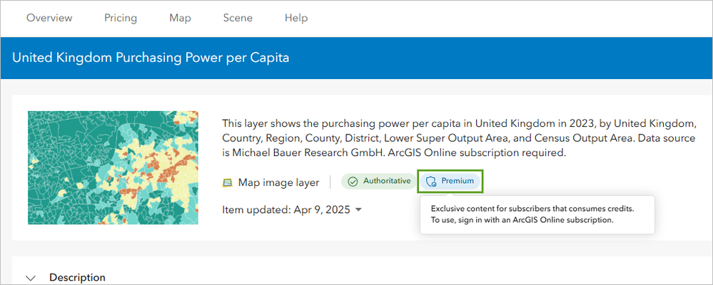

Some premium data layers cost credits for interaction. These can be recognized in ArcGIS Online by a Premium label.
If you add that layer (or other premium layers) to your map and share it you will be charged for interactions.
