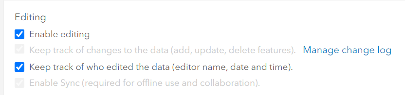

Regarding editor tracking what's the difference between 2nd and 3rd item here under editting and why is the third default to greyed out with an astericks.
The first screenshot is a view layer. The second screenshot is the layer the view was made from.

In regards to the editor tracking, since the first image is from a view layer this will take the editor settings and attributes of the original layer. We, therefore, couldn't have a View Layer receiving attributes on who last edited the view, if the original Feature Layer has editing tracking disabled, as this information could not be stored.
