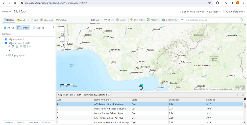

Hi, i am trying to create a map of closed down schools and was able to build the csv file, but upon importing it into ArcGIS Online the locations keep on ending in the wrong place.

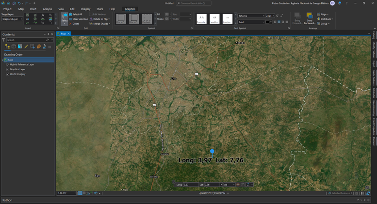

Hello Oluwaferanmi, It's hard to tell not knowing where is the correct place for your points, but you are probably inverting the Longitude and Latitude values.
Here is where the selected point is placed when inverting the values:

Oluwaferanmi
Thank you very much it worked
