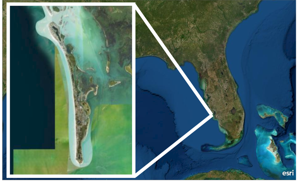

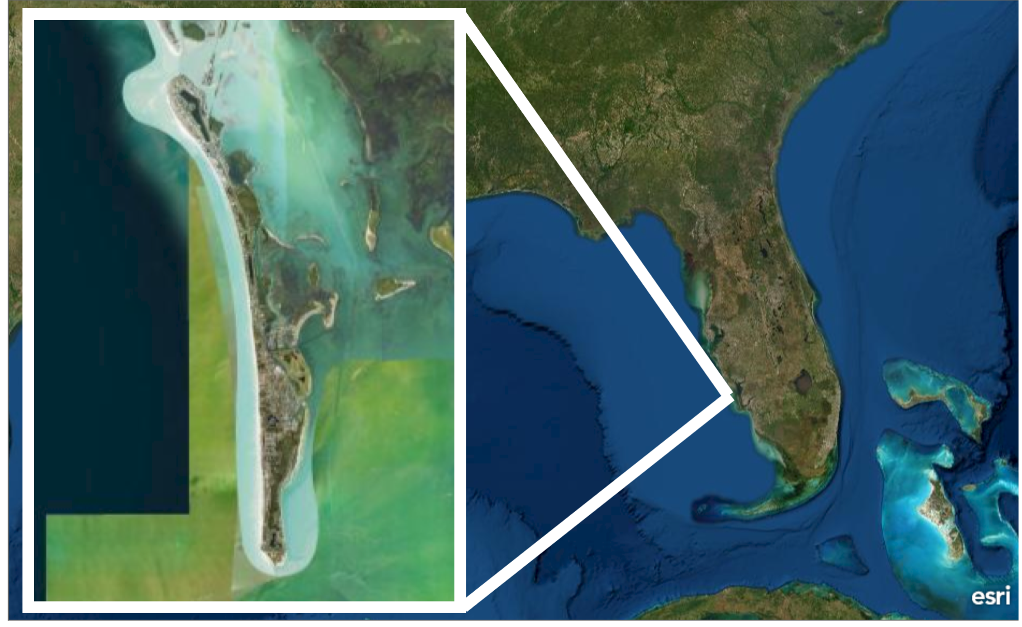

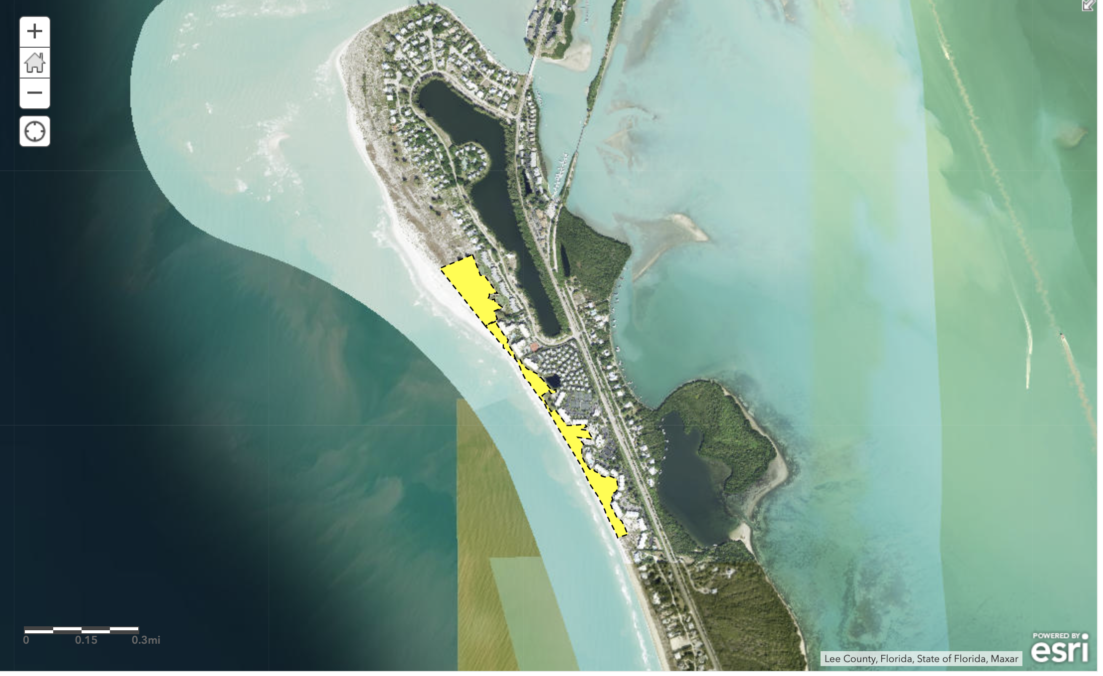

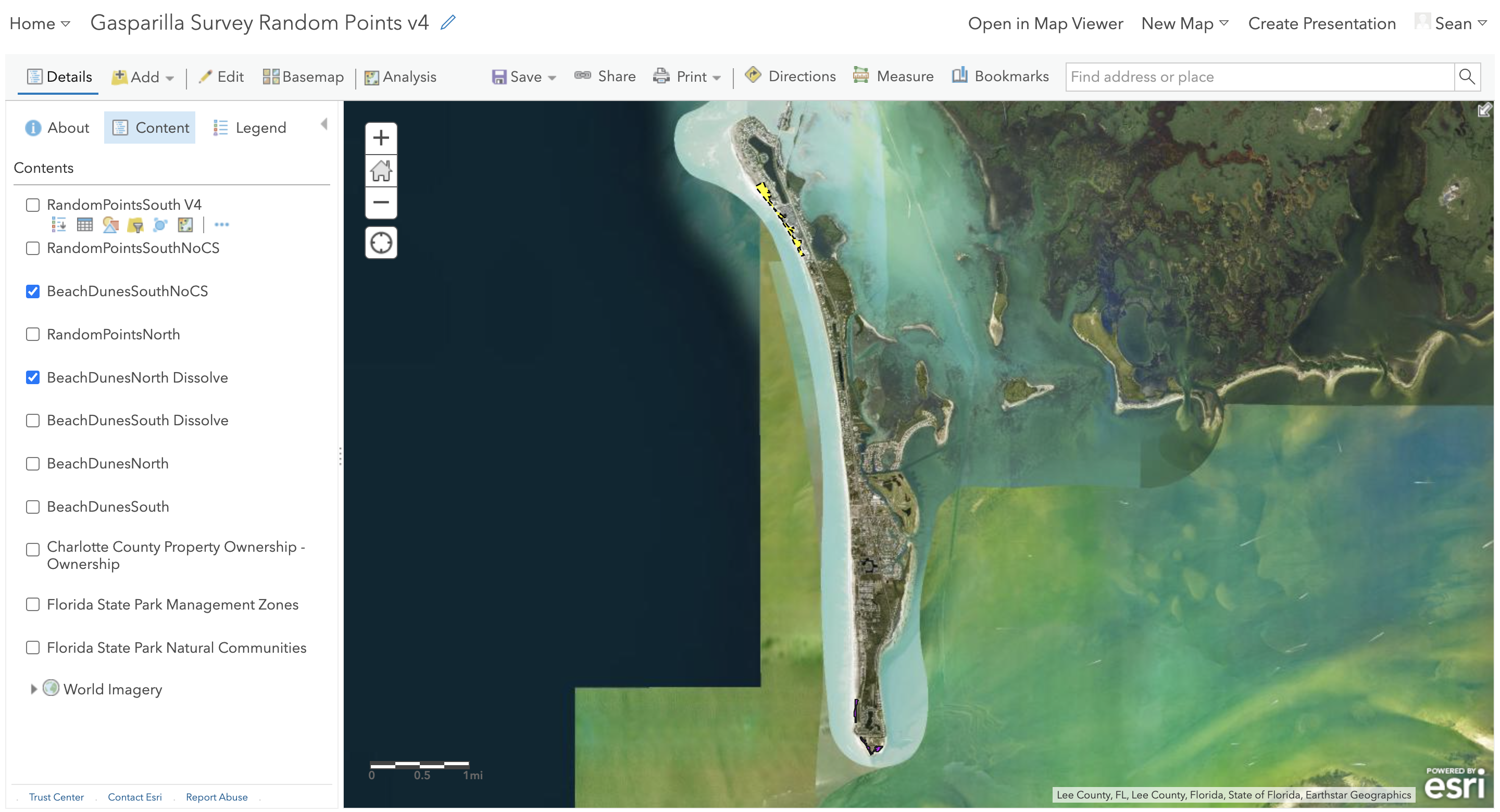

I need to create a map of my field site to include in a manuscript and my thesis for my MS. I need to show Gasparilla Island in relation to the rest of Florida, like picture 1, but I need to add a scale bar and compass. I also want to show where on the island the two sites are by highlighting them on the inset map like photo 2. I then need a close-up (maybe side by side?) of the two sites, like pictures 3 and 4, again probably with scale and compass? But I don't see how to make such a map on arcgis online. I don't have access to arcgis desktop so I am hoping I can do this in QGIS? But I can't figure out how to download or export my features to use elsewhere.

Hmm, maybe you could throw the map into a basic app and use the print function? It's pretty simplistic, but it has a scale bar.
But to export your features, you would go to each layer's details page , and there should be a button on the right-hand side, under the "open in map viewer classic" that lets you export the data in different formats.
