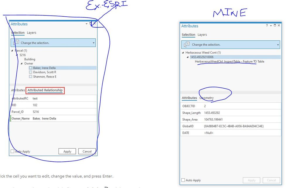

Hi @KevinMacLeodCAI, thank you for this! I thought I saw a response recently but couldn't find this message. So, I think the problem was not understanding that the auto-populate would only occur when the feature was created in field maps. So I'm good on that now. But our staff will often need to create features in the office and enter attributes in the related tables. Some investigating today leads me to believe they will have to do this from the Smart Editor App. We have used this before for copy/paste functionality but I was hoping it was be a little more streamlined. I need to make sure their workflow is as simple as possible. Before they can begin collecting more data, I have to import existing geometry and attributes from last year's work and I'm faced with the same issue in Pro..kinda scratching my head at the moment.  I think my relationship classes, even though working in Field maps, may need to be attributed. But even then, not sure the GUID will be created here to match the Global ID.  EditingRelatedTables_ArcPro.JPGEditingRelatedTables_ArcPro.JPGKristal
