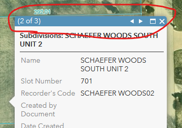

The popup itself should display a "X of N" indicator when your clicked location has multiple features.
The content of a single popup is defined by the layer, not the map. The click finds three features with popups, and thus three popups, then returns them as "stacked".
I know this is how pop-ups routinely work, but it's clunky. It would be much more elegant to construct a single pop-up that shows exactly what I want, be it from one layer or several. If that's only possible with custom JS, that is beyond my or most people's capabilities or time constraints. I guess this should be a feature request - something that's possible on any map, not just certain templates that are likely limiting in some other way.
