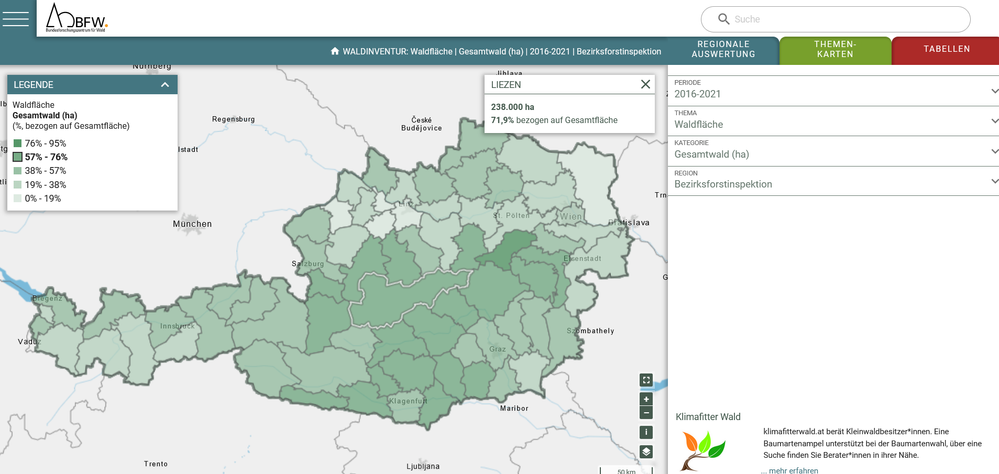

Hello,
I want to create Polygon Layers with ArcGIS Online from Excel Data. Whenever I import the data to ArcGIS Online it creates Point Layers automatically.
I don´t know what I´m doing wrong. I simply need an instruction on how to create Layers to visualize specific Areas with different color shades in order to express various information (like in the picture below).
Hopefully, you can help me.
Thank you!
Yours
Hannes
