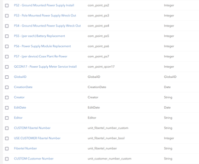

The only thing that it could be is that those might field aliases possibly and not actual field names or it might be that your criteria simply does not have a match.
Can you include a screenshot of the fields to see exactly what the issue is. It is hard to troubleshoot exactly when nobody can see what your seeing? It just needs to be a small snippet of the fieldnames.
LandonHarris

You mentioned you tried using the 'Expects' as it had been given, and it still returned a blank dictionary.
Can you run your code with console wherever there is a line of code that is running and paste a snippet of the results? You code looks fine, but it is strange that it doesn't return the fields you are looking for.
