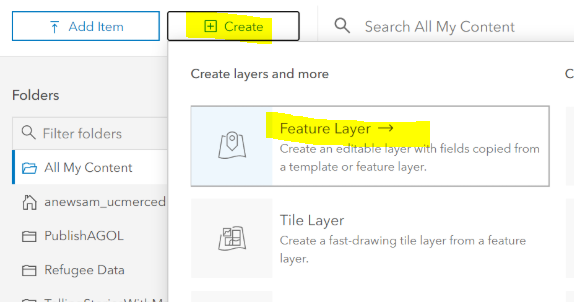

I'm exploring options in AGOL, and it seems as if "Create Feature Layer" only allows you to create 3 layers, one of each type (point, line, polygon), and then I can't figure out how to add more layers once you've got the map open and are working with it.  Map Notes doesn't have the same options as the layers created with the Create Feature Layer method.  Am I missing something?        Thanks - Amy

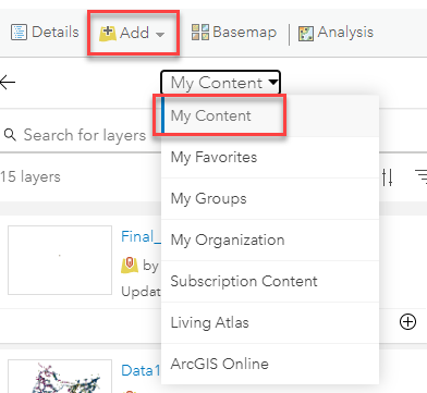

When you are going through the process of creating points, lines, polygons it will create individual "Hosted Feature Services" in your organizations content. If you would like other layers added in the map that you have created or uploaded it will be under "My Content"
If you would like to add content into your map that your organization has created, you would click "My Organization"
