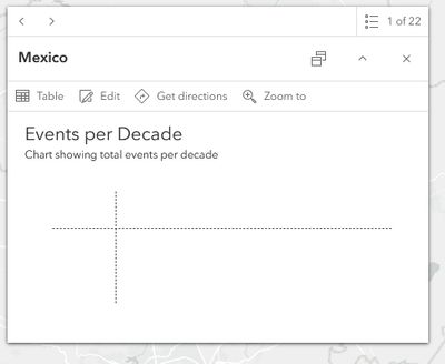

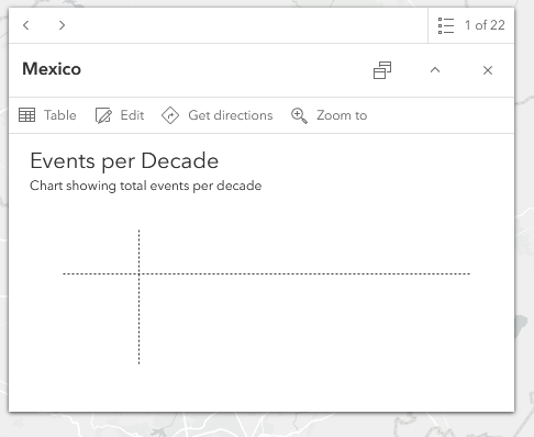

I am trying to create a column chart in a pop-up using an Arcade content element, but the result is a blank chart.
I have succeeded elsewhere with other Arcade pop-up charts, but in those cases I had used a featureset as the data set.
Now, in this (unsuccessful) case, I am using a data dictionary of key:value pairs in which keys should be 30 decades between 1520 and 1810 and values are an aggregated count of ecological crises experienced at the particular location.
The resulting data dictionary ("decades_dict" in arcade script below) looks good:
{"1520":0,"1530":0,"1540":0,"1550":0,"1560":0,"1570":2,"1580":1,"1590":0,"1600":0,"1610":1,"1620":3,"1630":4,"1640":3,"1650":0,"1660":2,"1670":0,"1680":0,"1690":6,"1700":0,"1710":0,"1720":0,"1730":0,"1740":0,"1750":0,"1760":0,"1770":0,"1780":0,"1790":0,"1800":0,"1810":0}
The resulting chartNames array, however, does not look right. It is not grabbing the keys from the dictionary but only the values. Thus it looks like this:
["0","0","0","0","0","2","1","0","0","1","3","4","3","0","2","0","0","6","0","0","0","0","0","0","0","0","0","0","0","0"]
So, I need help making the chart render properly AND to make sure that "chartNames" has an array of decades  (i.e. the keys of the dictionary, not its values) which are represented as strings.

KenBuja
MVP Esteemed Contributor
When you loop through the dictionary in line 24, the variable n is the key name. You just need to modify your loop like this
for (var n in decades_dict) {
  //Make chart monochromatic
  Push(chartColors, [6,47,120])
  Push(chartNames, n)
KenBuja
  Push(chartNames, n)
BradSkopyk
So simple! Thank you!
