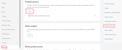

If you are the administrator of your AGOL organization,
navigate to Organization > Settings > Security > Trusted Servers. Add the WMS Server.
Once you've added the server to the list of trusted servers, you can add your OGC services to Map Viewer Classic or as an item. If authentication is necessary, users adding or viewing secured OGC layers will be prompted to enter their credentials.
OGC WFS, WMS, and WMTS services secured with token-based authentication are not supported.
Secure OGC Services - ArcGIS Online

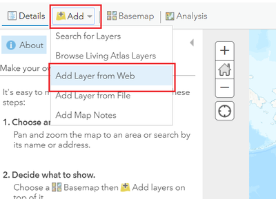

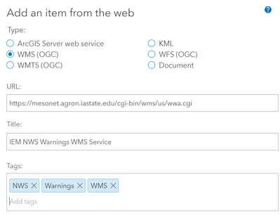

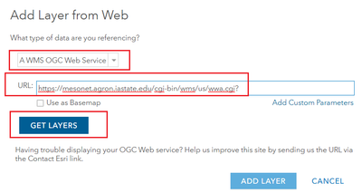

You could add the WMS Layer(s) to ArcGIS Online directly.
From Content
Alternatively, you may add the WMS Layer(s) directly to Map Viewer of ArcGIS Online.
