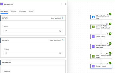

If there's not a quick answer on using an ArcGIS connector for this, here's how you can do it via an HTTP action instead:
Overview/proof of concept:

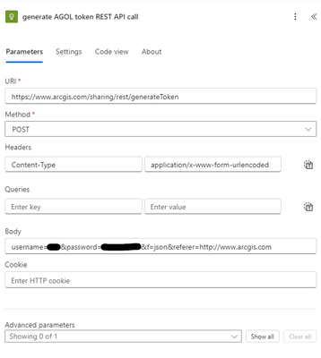

HTTP action to get AGOL token with REST API

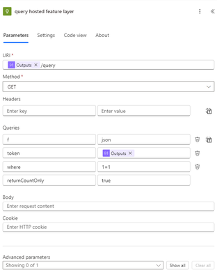

Query hosted feature layer HTTP action using REST API
Note: the URL for the hosted feature layer needs to include the /0 or whatever the sub-layer index number is.
