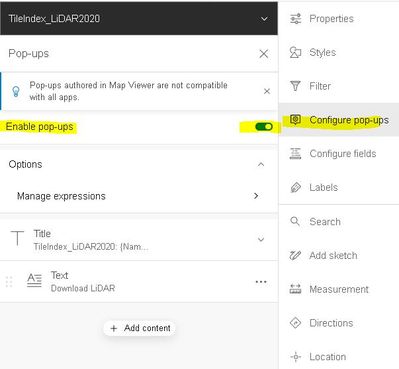

Attached are screenshots of the same service in the same map; you can see there are no pop-up related options in Map Viewer (new).

Is this what you are looking for?
