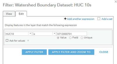

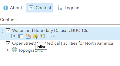

Filter your Zones
First, you'll need to limit the features in the rainfall layer. Click the Filter button and define an expression so that only "Marginal" features are included in the output.
