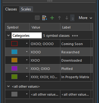

I made a simple map in ArcGIS Pro 3.0 where my one layer has combined, or grouped, symbology, like this:
There are only five classes yet that green class at the bottom is a combination of seven items. In Pro, this works normal and as expected.

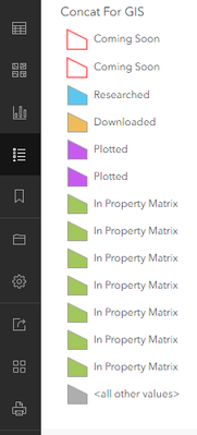

Once it gets to ArcGIS Online, the legend spaces itself out, like this:
How can I combine these in AGOL so it doesn't look spread out?

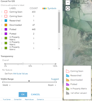

One interesting thing is that in the Map Viewer Classic, they get combined in the legend:
But, if I go to edit my symbology in Map Viewer Classic, they get ungrouped again:
