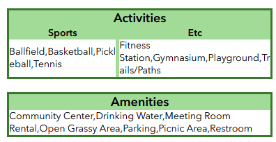

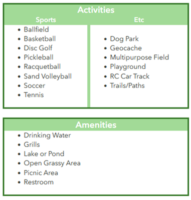

In my pop-ups, I have 3 Arcade expressions similar to the one below. Prior to yesterday's AGOL update, this expression was returning a bulleted list (one value per bullet). Since the update, it's now returning a long string of values separated by commas. How can I fix the code so that it again returns a bulleted list? I can't find anything in Esri's list of updates that would cause this?

What it used to return:
What it's returning now:

AnneFitz
Hi @MelissaSullivan - the behavior you are referring to was undocumented and not part of the WebMap spec. To create a bulleted list of items from an Arcade expression, I would recommend using the Arcade content type in your popup and returning the "Text" content type. This will allow you to return HTML content, like an unordered list (<ul>, <li>). You can see a similar example in this blog post: https://www.esri.com/arcgis-blog/products/arcgis-online/mapping/summarize-and-explore-point-clusters...
