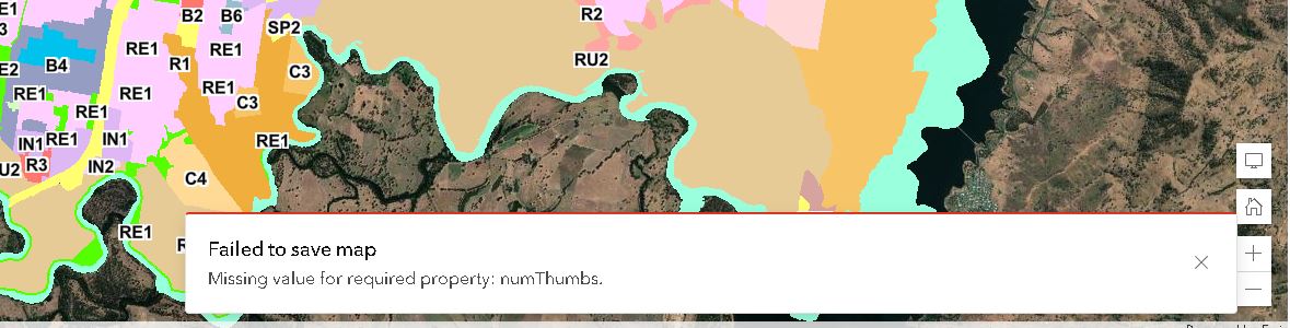

I have uploaded a new feature layer to Agol to add to a new map. After I add the layer to my map I am unable to save the map as it states I am missing parameters "numThumbs" which does not exist on this layer on map. Is there somewhere I cannot find where this "numThumbs" exists?

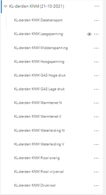

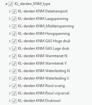

  1. published from ArcGIS Pro as a 'group layer' to have the layers as one hosted feature layer:
  2. Added the layers to an existing map and add them to a group:
