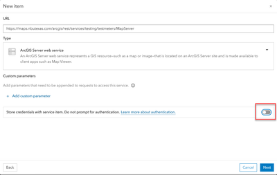

@KarenLizcano1 are you adding the service by going to Content > New Item > URL?  This worked for me:

yes, but when i move the slider to save the credentials, and put them in and hit next it gives the error.  I know they are the correct credentials because they work when I dont save them and add the service to a map and put them in.
