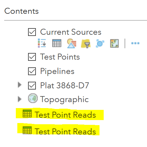

I have a web map which contains a hosted feature service with 3 layers.  The first version of the service contained related tables.  I made changes to the service and removed the relationship classes and the tables.  When I republished the service, the web map still shows the tables in the TOC.  They are no longer part of the service but I cannot remove them from the web map - when I click on the table, nothing appears appears - no context menu or icons. Is there a way to do remove the tables without having to create a whole new web map?

Thanks Michael.  I did check the REST endpoint and the tables are definitely NOT part of the new overwritten service.  They are just strange relics hanging out in the web map.  I'll check out the link you sent.

I'm having the same problem. The related tables are completely gone from the feature service, but the web map is hanging on to the tables with no way to delete them from the map. There isn't anything in Online Assistant that allows you to delete layers from a web map, but they do show up as layers in that format.

Same issue.  Unfortunately, all of a sudden the remnant table seemed to be the cause of users being unable to take the map offline.  I attempted to remove the tables item link in AGOL Assistant, but that didn't work and led to more issues.  Forced to recreate the map; now everything works fine.

I'm having the same issue. A hosted table no longer exists but the reference in the web map is still there.It's very confusing to have an old ghost table throwing an error when the webmap is opened. This is for a University GIS lab so the students get very confused. I'll just have to recreate the web map and update the link in the lab write up. This time it's not a big deal, but it would be a real  pain if the map was linked out to StoryMaps or Dashboard. Any update is greatly appreciated!
