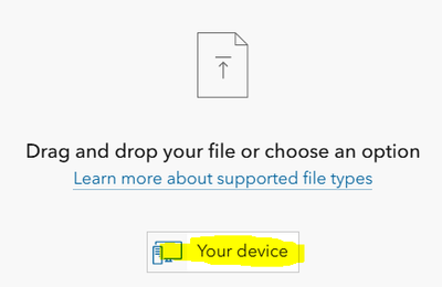

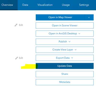

I had a similar experience as yours where I attempted to Append new (selected) features from Local File Geodatabase to Hosted Feature Layer.  A number of them actually appended over to Hosted Feature Layer, but there was a warning that identified one Object ID that that had an unknown issue.  It appeared that all the records after the problem record were not Appended.  I attempted to Append without selecting the problem record, but the Append was not successful, even though it appeared to finish the process with a message of success.  I tried that a few times without success.  Finally I logged directly into my AGOL organization account to use the Update Data --> Add Features--> Upload the Zipped File Geodatabase.
Keep in mind you need to create a separate File geodatabase that has only has the feature class that includes the new records that you want to Append/Add to your Hosted Feature Layer.  And you need to zip that File Geodatabase.   This was successful.
