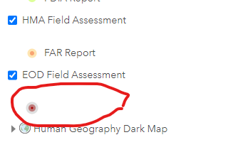

I have hosted layers with point geometry and loaded them on my map. Some of the layers in the legend, do not have labels and have no idea how to edit them. Data for these layers are collected through Survey123.
Is there a way to add labels or edit these point labels in the legend? Any idea will be appreciated.
Below is a snapshot of the two layers:

3raan
Hi @SayedWali, the circled item in your screenshot is the symbol according to selected fields. Not the layer. "EOD Field Assessment" is the layer in this case. Can you provide a screenshot what appears when you select the style settings for the "EOD Field Assessment" layer?

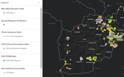

Let me explain better, we are a third party monitoring org for demining agencies. For each activity, I have one layer, so I added them to a single map, I selected one specific style for each layer (selected no other field). So now for some layers, I have a label beside the symbol but for some layers there is nothing. I can't add or edit labels for them.
If I choose a field in style setting, yeah I can put labels and edit them.

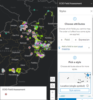

So here I put a screenshot (you see the layers, each is one type of activity):
And here is the Style setting, you can observe that I have not selected any field:
