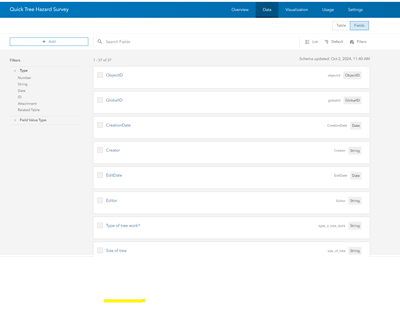

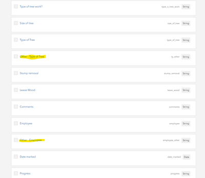

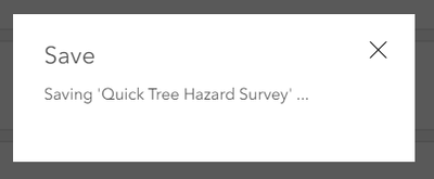

I'm trying to delete a bunch of fields labeled "Other - [Field Name]" that I got from a survey123 that someone else made. I have full permission to add, edit, and delete these records. When I try any other record it works just fine, but the "Other - [Field Name]" records just get stuck on the saving screen without doing anything.

I'm trying to delete the field. There are nine fields labeled "Other- []" and I'm trying to delete them from the data tab on the on the items detail page

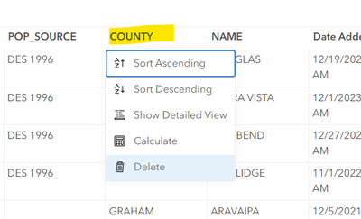

  1. Map Viewer- you can can now delete a field using tools on the Fields pane, this article will walk you through it.

I have permission to edit and delete this layer. I was able to delete to fields that weren't "Other" without issue. I have the same issue trying to delete through your suggested work arounds
