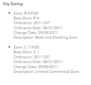

Hello all,
I'm getting bullet points when I return the values in an Array. Does anyone know why they're appearing and how to get rid of them? The pop-up looks like this:
We'd prefer no bullets, as the rest of the pop-up doesn't have any. Any ideas?

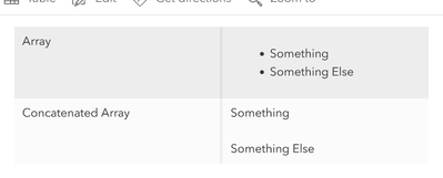

Distinct(zoning) will return an Array, which the popup renders as a list. To remove the bullet points, you'll need to convert your array to a single string.
Try Concatenate(Distinct(zoning), '\n\n')

LDreyfuss
Thanks so much, Josh! That worked!
