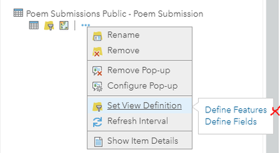

Since posting this, I'm finding that the "Define Fields" definition now works and successfully hides fields in the Join Feature Hosted View Layer. However, the Join Layer still will not inherit the "Define Features" view definition. I have it set to only show records reviewed and OK'd for public viewing, but all the records end up in the Join. Bug?

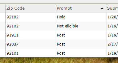

I can successfully apply the Feature Definition on the table, ie. "Prompt" == Post:
But in the Join Layer, I still see all records come through.

1) Create view definition of the Table, and add a view definition to the View (hide fields, filter for certain features)
