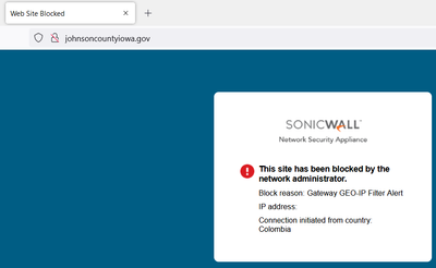

I think the reason that I cannot access the website, is since it blocks access from Colombia:

Regarding the Colombia thing - are you in Colombia?  Or is it saying my connection is in Colombia?  I'm in the US.
