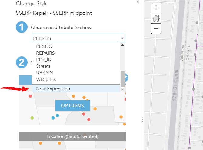

JeffreyROLAND
This can be done in the picklist where you choose the unique field to attibute. Just choose New Expression which can be found at the bottome of the picklist (see attached) screenshot.
Arcade is a scripting language not too different than VB script. You can select two fields in the expression builder and put a concatinator  in between the fields.
The problem I'm having is that now the OPTIONS button does not let me customize the style symbol. I'm stuck with the default color circles that it gives me!
