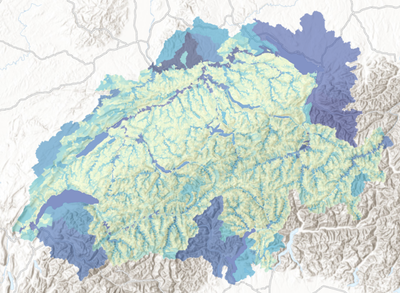

Hi @NoahLeimgruber ,
To include the min and max values in the range and also include the area of the polygon itself, you just need to change this line:
if oid != oidcurr and lst[0] > h1 and lst[1] < h2:
into this:
if lst[0] >= h1 and lst[1] <= h2:
This will assign a catchment area value to all polygons:
