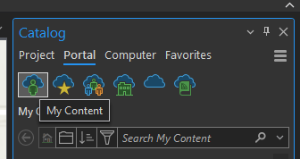

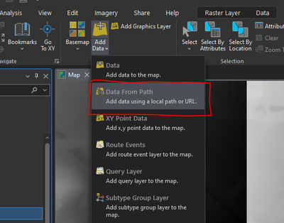

Robert, instead of using the data tab, like mentioned above (though, that might be easier), you can bring in your ArcGIS Online data into Pro without having to export and then re-publish. All you need to do is either add data from path from the add data button:
Or, just go to your portal in your catalog pane and find the data that way. Then you can edit the data just as you would in pro with a file geodatabase feature class (and the data in AGOL will update as you edit it).
