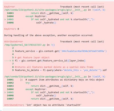

Thanks for your script! However when I I have tried to run it on my end, I am getting this error. Any suggestions?
AustinAverill
On line 17 in my code, I made an error. It should read:
fl = gis.content.get(feature_service_id).layers[layer_index]
Sorry about that. Typed it out in a hurry yesterday. Lol
