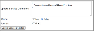

  1. Look for the following parameter: "sourceSchemaChangesAllowed" : false
  1. Change the parameter from false to true and delete everything else in the window, such that it looks like this (you can check your formatting with JSONLint😞
  1. Click Update Service Definition and repeat this process (first 6 steps) for any other views created from the layer you want to edit.

SFM_TravisBott
@NicoleJohnson Well shoot dang! You're right that I didn't read carefully - you specifically mention joined views in your post.
I used your technique and it worked perfectly. Previously I've done it by going through the REST endpoint for the parent layer, and I had never come at it from the view itself. Seems to have worked fine. Thank you!
