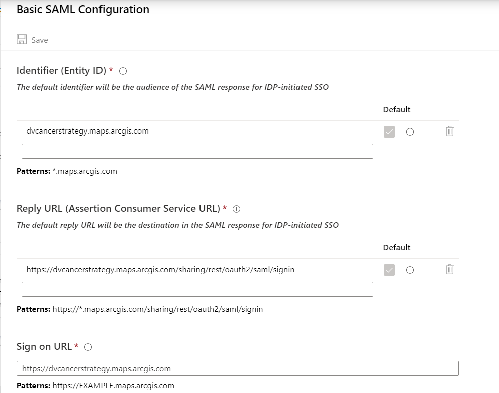

1. Editing Basic SAML Configuration

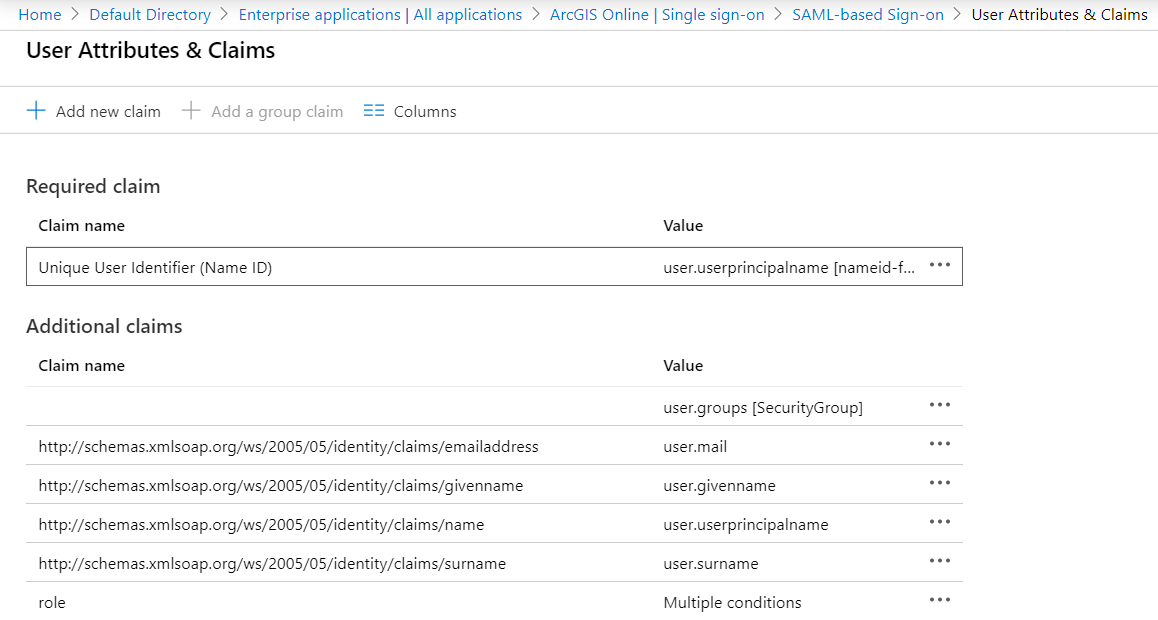

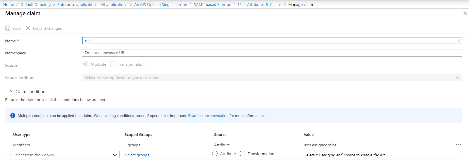

2. Edit Claims and Attributes:
Edit Claim and Attributes - 2

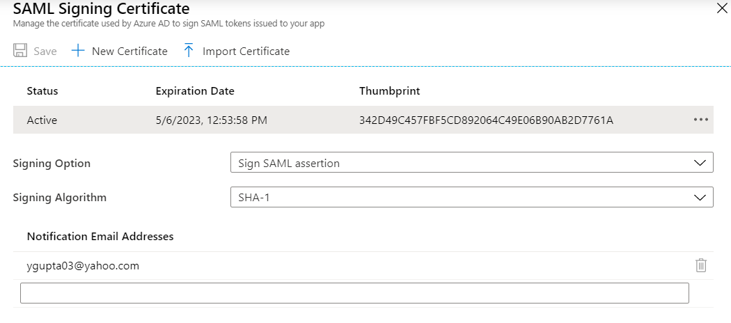

3. Configure certificate sign-in algorithm.Configure certificate sign in algorithm

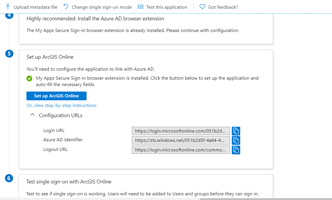

4. Extension Installed and Click on "Set up ArcGIS Online".Extension Installed and Click on "Set up ArcGIS Online"

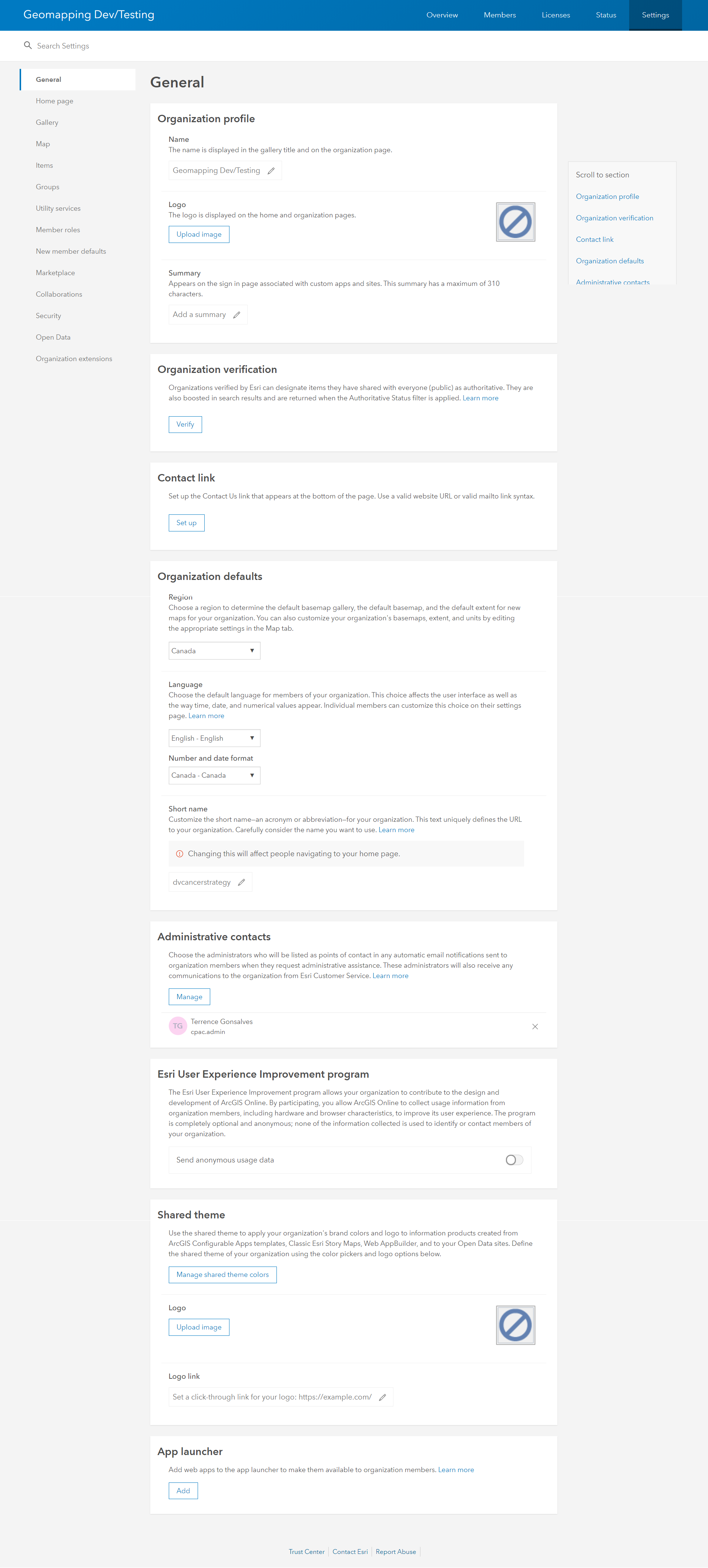

5. ArcGIS Online General Setting:
ArcGIS Online General Setting Tab

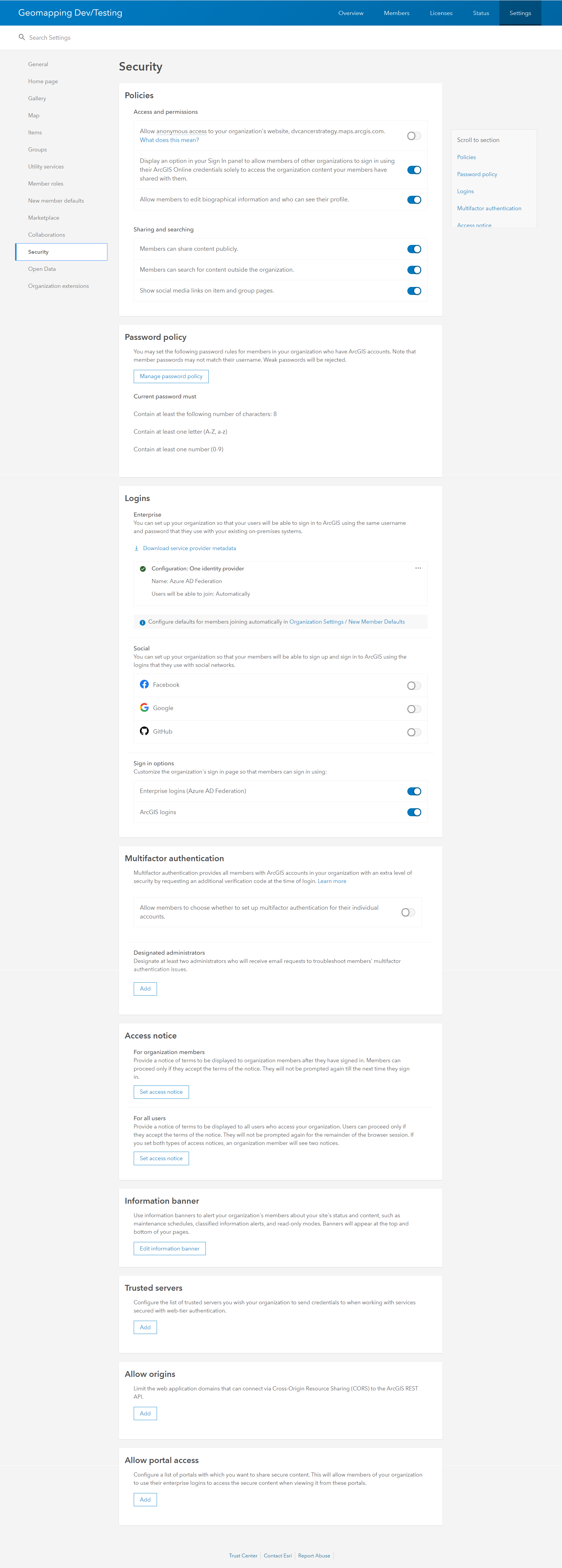

6. ArcGIS Online Security Setting:

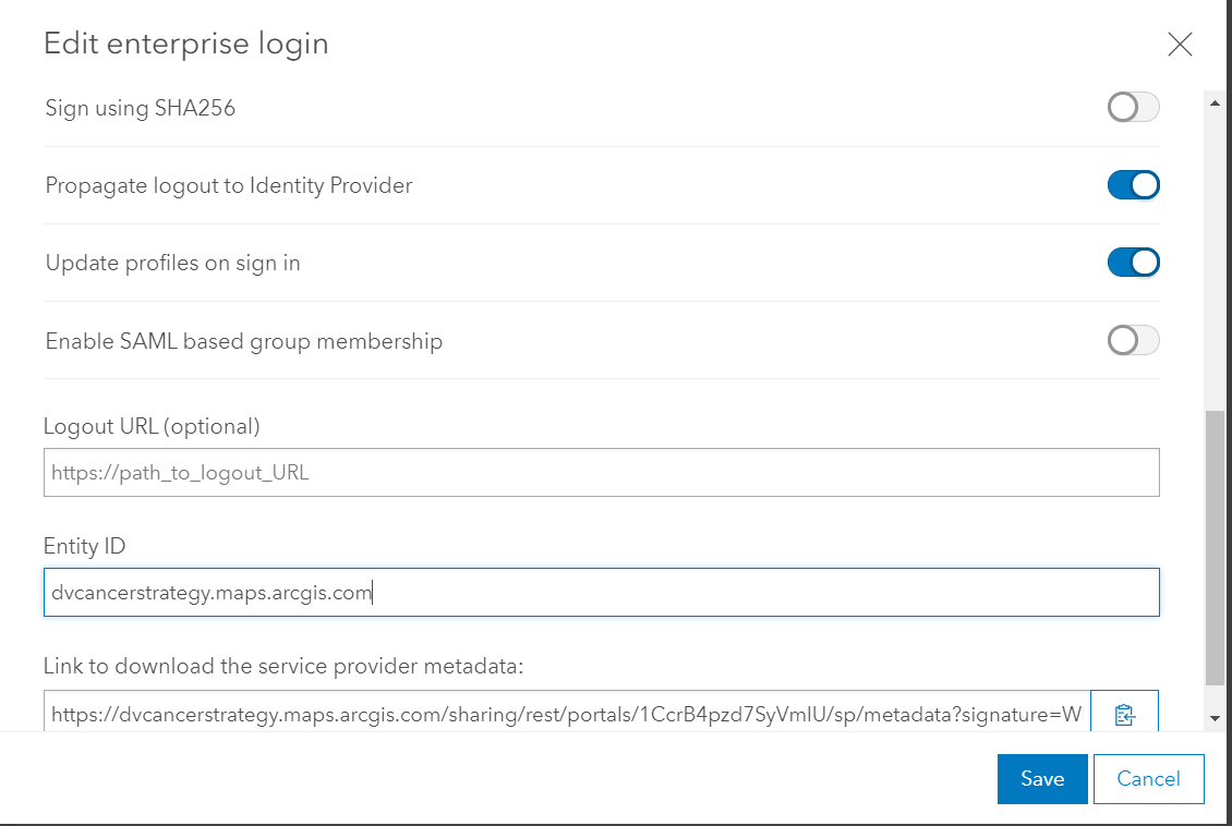

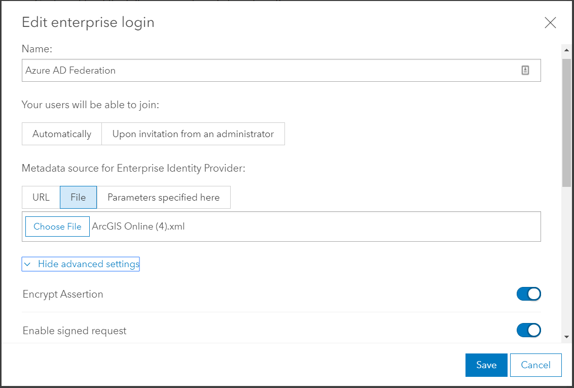

7. Edit "Enterprise Login":
Edit "Enterprise Login" 2

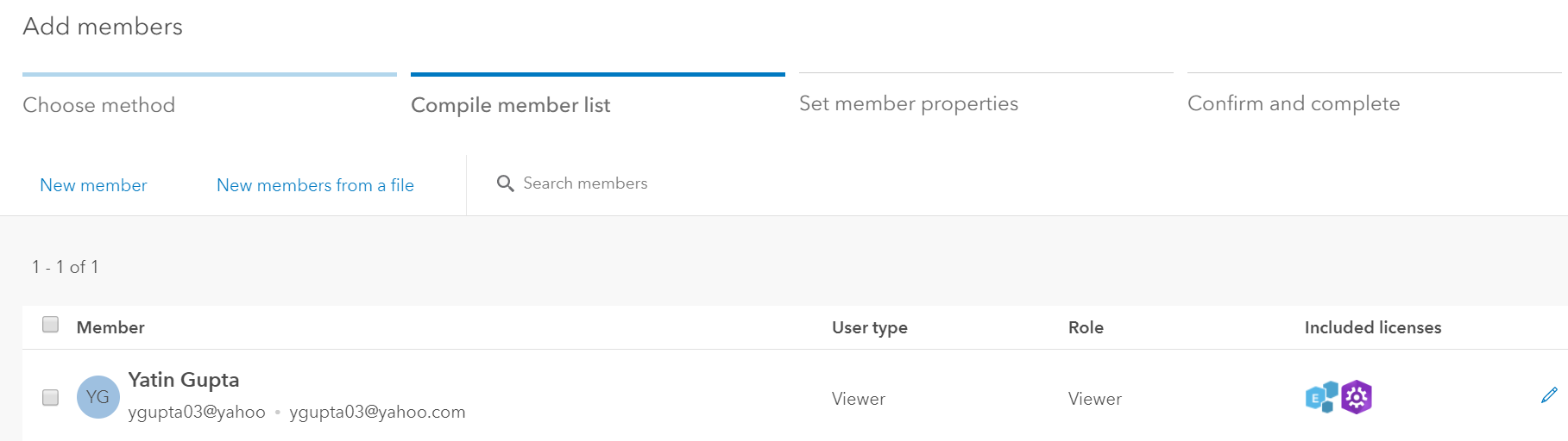

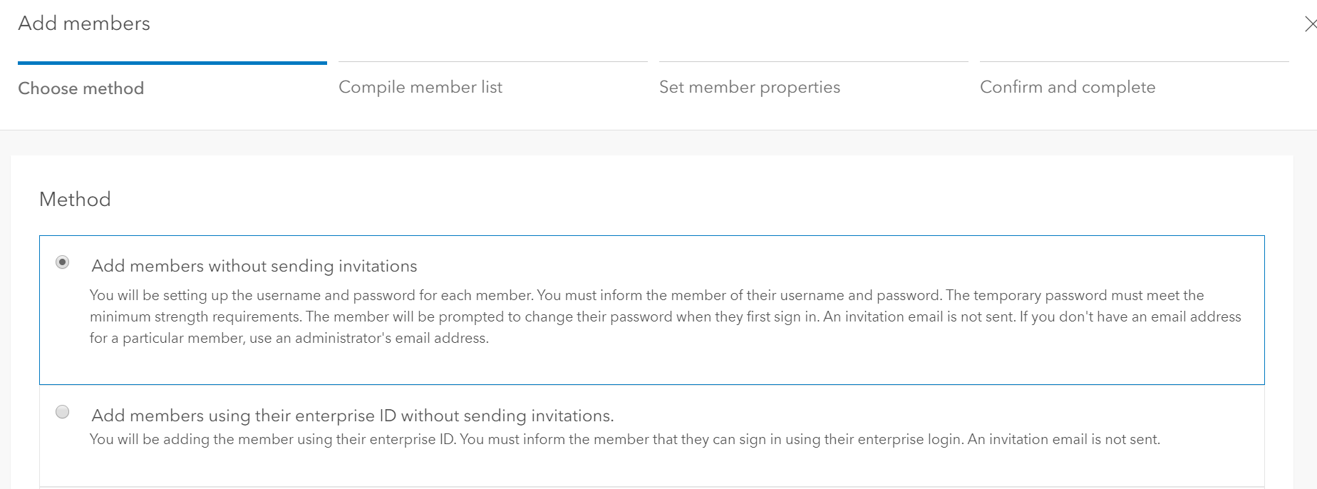

8. Invite New Member
Invite New Member
Invite New Member 2

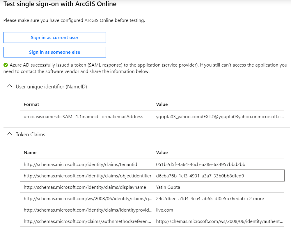

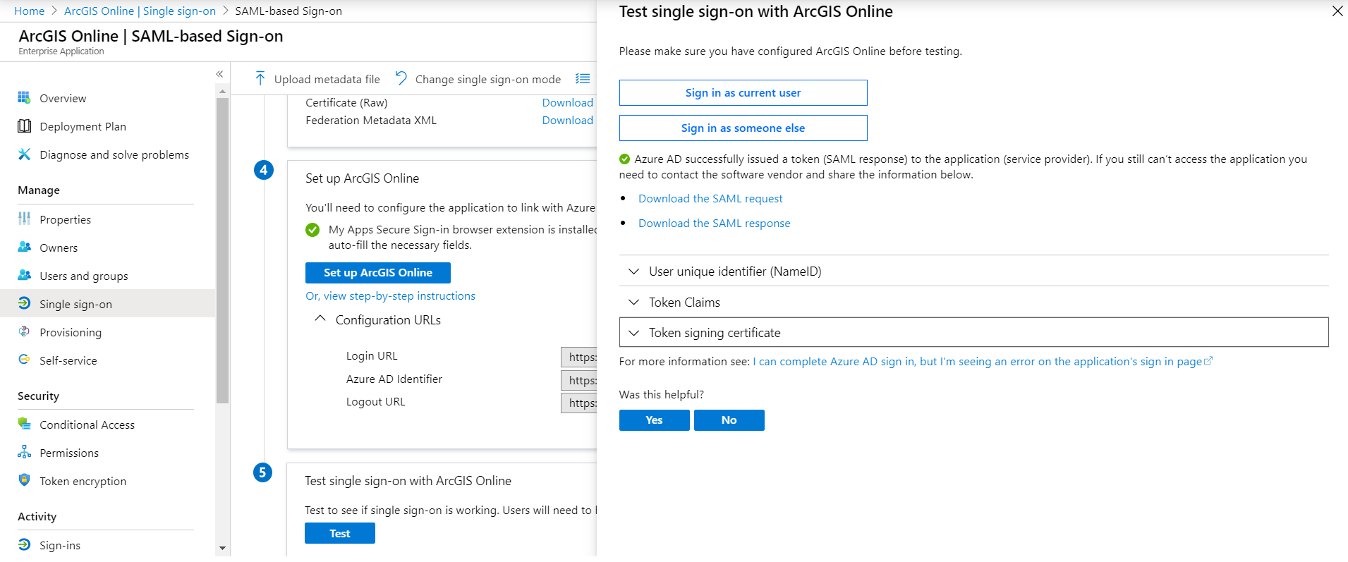

9. Azure SSO Test - Success

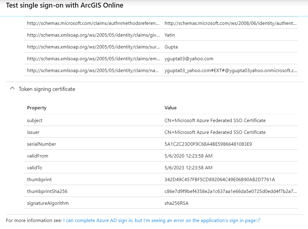

10. Claims sent in SAML request:
Claims sent in SAML request - 1
