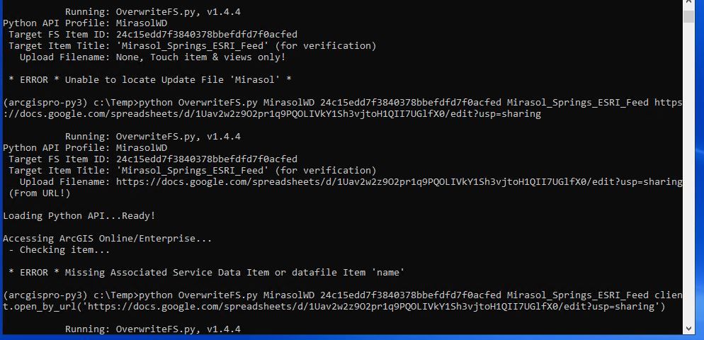

I am currently trying to use the Overwrite FS script to work and then just schedule a task to update every hour, but I am stuck in the Command prompt trying to get it to overwrite manually (see attached).
Thanks again for your help.

Where is that script coming from? I've not used it before. I like to develop my own scripts and functions in Python, as it's a bit easier to understand what's actually happening "under the hood", and you can tailor the process to your particular situation.

Ahh good to know, thanks for the clarification Josh. I found this article on automation. This is where I got the aforementioned script and workflow.
https://learn.arcgis.com/en/projects/schedule-automated-near-real-time-data-updates/
jcarlson
MVP Alum
Thanks! Well, it's tricky with Google Docs. The link you have isn't really to the "file". When you add it to your content, what's happening behind the scenes is that the entire sheet is being read as a temporary text object and then imported from that.
If the Google Doc was a literal file, this could maybe work. Where's your Google Doc pulling this from? Are you doing any data manipulation there, or is it basically a copy?
