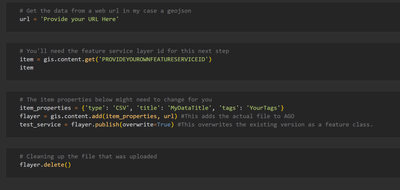

I've just set one up that is reading a geojson file from a URL. But you could do the same thing with a CSV or Excel if you needed. It was pretty easy for me to do this  but I'm not sure how easy via dropbox, especially if it has to authenticate before it gets to the file. If the file is public.
I'll assume the file you are sharing is in a public folder and is something Esri knows how to read, say a CSV.
If that's the case and when you open the link, it directly opens the CSV you should be able to use it.
I'll attach a smaple code below which assumes you've already created a feature layer from a previous version of the file and you know the service ID.  I'ts pretty simple. Once you've got it running, you can set it as a task to run on your schedule
