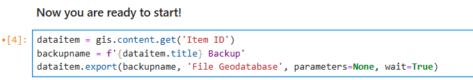

@MobiusSnake This is what I have so far.
The backup ran successfully in a notebook with the code in the first screenshot. It saved a copy of the layer to my root folder in AGOL.

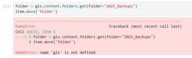

What I'm stuck on now is how to connect the move function to move the export to a backup folder. I tried running the code in the second screenshot after the first code chunk, but I keep running into an error.

Hey Jon what are we using for the imports and authentication?
from arcgis.gis import GIS
gis = GIS("home")
I presume you have the following given the initial gis.content.get worked. Maybe worth checking that the account being used within the script has access to the 2025_Backups folder?
