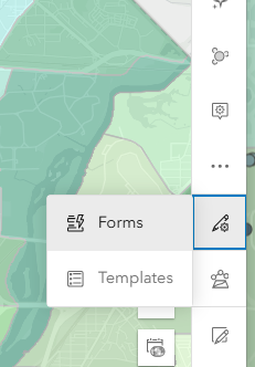

I'm trying to configure an editing workflow in the map viewer and eventually into an Experience. In Map Viewer Classic, you could configure the popup and decide which fields will be visible and editable. This would be used in an app to limit what users can edit and see.
In the new map viewer it is easy enough to hide fields in the popup but any editing widget in the map viewer or experience app shows all the fields and allows edits on all fields.
Is there anyway to do this as showing all the fields will cause confusion for some users?
EDIT--------
I think I found it. There is a Configure Editing button on the side
EmilyGeo
Hi @MichaelKohler
Yes, in Map Viewer Classic the form was based on the pop-up. In Map Viewer, pop-ups and forms can be configured separately.
As you've seen, the Configure editing button is the starting point. From there you can launch the Form builder. In Form Builder, you can either create a form from scratch, or based on the existing pop-up. That can be helpful if you've already put a lot of work in the pop-up and want the same fields to be visible on the form.
