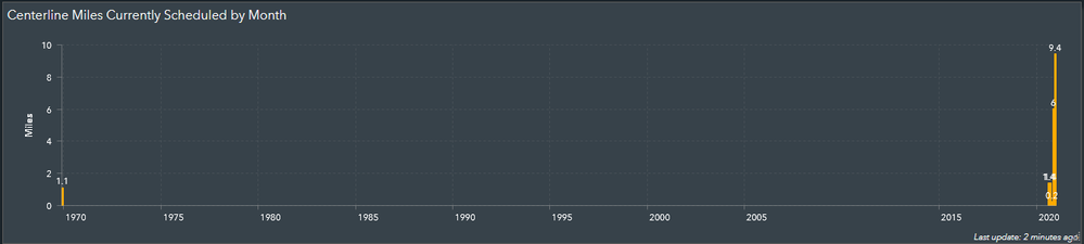

Hello! Here in 2020, still seeing this issue, with my Dashboard widget. The workaround (adding an "is not Null" filter) of course works, but does anybody have information about this in a more general sense? Will Null date values always default to this date?
Null values showing a date of 12/31/1969:

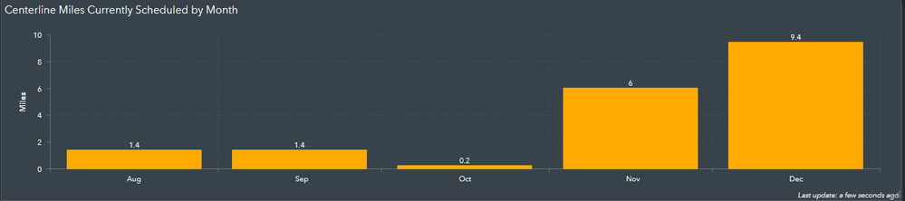

After adding an "is not Null" filter:
