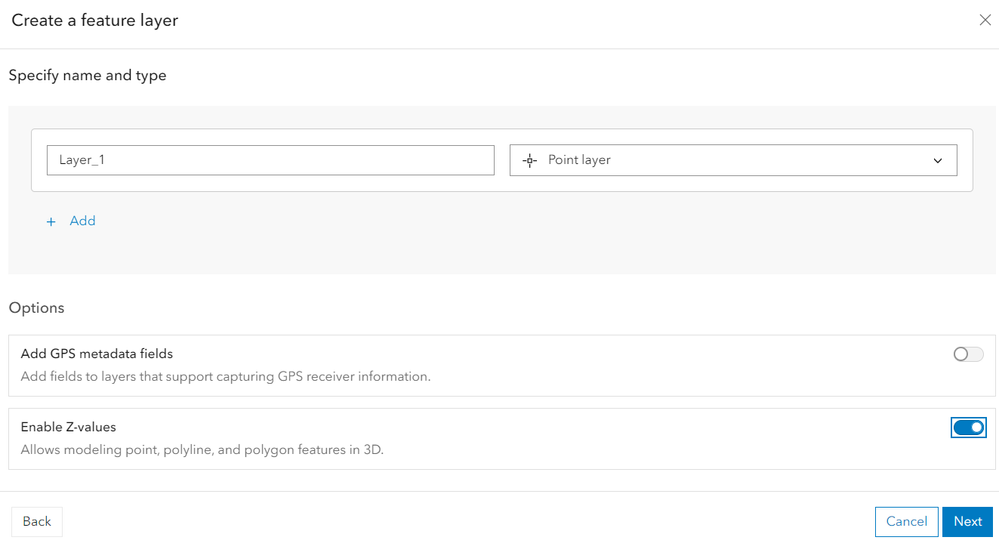

I suspect while the layer has altitude information it is not Z-enabled.
The best way I find to resolve this is to create a new layer and ensure this toggle is enabled
From here you could recreate the attribute fields then append the data from your csv and use this in the scene.

Thanks for the response - this pattern makes sense but seems a little cumbersome -so there is no way to enable this on creating a feature layer from a CSV (which is useful because it infers your schema), and no way to enable it after a feature service has been created?
