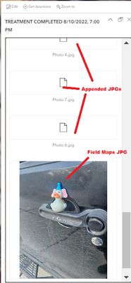

Hi,
I have ArcGIS for Portal and am trying to make a field service map that will have data appended to it regularly as field service is done. Prior to each update, I need to separate out some points and only append a few of them. This data has attachments that I want to be visible in the form of thumbnails in the popups.
To try this out, I made my map. I opened the field service report in ArcGIS Pro, selected the data I wanted, clicked layer from selection. Exported that selection to a feature class and then told it to append that to my hosted feature layer in my portal, keeping attachments.
It did that, but now the attachment thumbnails aren't showing up. What am I doing wrong? Below is how it looks like with the data I appended vs how it looks like on the target layer.

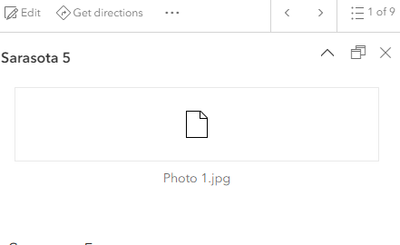

DavinShokes1
Any luck with this? I am also finding that appended features with attachments show no picture in the popup. The attachment must be downloaded before viewing as there is no thumbnail.
Seems like an issue with the append in Pro as adding the same image in Field Maps and Map Viewer produces a thumbnail.

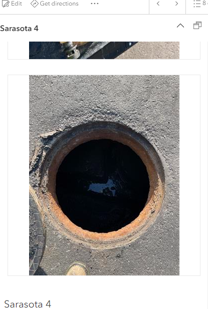

DavinShokes1
Mine appeared to be a bug during append that I couldn't reproduce. Reran the append and the new features have thumbnails on their attachments.

ChelseaRozek
MVP Regular Contributor
Anyone know of a way to fix these attachments without having to reappend? We've since edited the dataset so we can't just truncate those records and reappend.
I figured it out using the Python API:
thehostedlayer = gis.content.get('ITEMID')
mylyr = thehostedlayer.layers[0]
fixoids = [1062,1063,1065] #made a list of the 100s of objectids of features that needed fixing
for oid1 in fixoids:
    attachment_IDs = [a["id"] for a in mylyr.attachments.get_list(oid1)]
    for attachment1 in attachment_IDs: #goes through each attachment, so it's fine if the feature has more than one
        filepath = mylyr.attachments.download(oid1,attachment1,r"C:\Users\myname\Desktop\temp")
        mylyr.attachments.update(oid1,attachment1,r'%s'%filepath[0])
If you use mylyr.attachments.get_list(objectid), you can see before you run the script, my attachment type for photos were 'application/octet-stream'. after the script, they became 'image/jpeg' and finally displayed properly in the popups in my webmaps. There was a delay, though, even with clearing my cache. I left my PC for about an hour and when I came back the popups were fixed.
