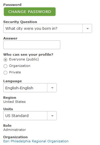

JakeSkinner
Esri Esteemed Contributor
Have your client check that their profile is available to the 'Everyone (public)' my going to My Profile > Edit Profile:
CarynAshbay
Great!  Thank you, you just saved me a ton of time!
