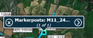

A user is currently having issues when viewing a pop up in a web application, although it seems to be working OK with other users. The pop up is coming up in a different format with no attributes showing and when expanding, it won't allow them to scroll.
They are using an up to date version of Chrome and pop up's are enabled, but it happens when clicking on any layer in the web application, even when they're shared to the whole organisation.

That's the style for popups on mobile devices. It also appears on PC if the Browser window is small. Try maximizing the Chrome window.

Just tried it on mine and that's the cause, so simple! Thank you

The app supports two styles of layout based on the screen size. One is for desktop and one is for mobile devices. When either the height or width of a screen display is less than 600 pixels, the mobile layout is applied automatically. However, this may result in unexpected behavior when the app is embedded in a website. For example, the pop-up in the website changes to the mobile layout style. To control the layout style, use mobileBreakPoint=<pixel number>. For example, you can remain in desktop style until the screen size is less than 300 pixels, as shown below:
https://<your app>/?mobileBreakPoint=300

I also see this issue w/ very large screens as well, such as big screen TVs in conference rooms... which is odd... there's more than enough space obviously.

This was happening on our office's TV/Smartboards turned computer screens.  I found one workaround, which involved clicking in the white area of the pop-up (to activate it) and pressing the tab key to get it to "travel" to the bottom of the pop-up.  Luckily, while I was working on this workaround, a guy from our IT Dept was setting up my printer and offered to help me find a better workaround!  This is a rare occurrence, so I took him up on his offer and he delivered!
To fix: Click on the browser window (to make it active).  I used Chrome and Firefox with the same results.  Once browser window is active,  use ctrl and + or - to zoom in and/or out.  You can also zoom out using the browser settings or ctr plus mouse scroll.  I found 80% zoom will bring the pop-ups back to normal (the way they are supposed to look) on my TV Screen (turned computer monitor) but you may have to go lower depending on the size of your screen; test it out to see.  As long as your browser is zoomed out, you should have no problems with scrolling in the pop-ups.  If you zoom the browser window back in to 100%, the pop-ups go back to the huge white screen that is not scrolling.  Just found out If I hide the top bars in Firefox and keep zoom level to 100% the pop-ups still work the same.  Play around and find what works for your setup!
