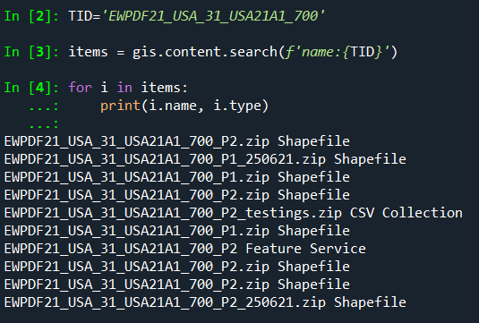

I am using the arcgis python api to download feature layers from the account.  Sometimes the api does not find/recognize the feature layer.

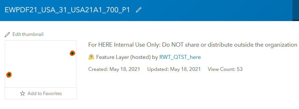

Here is the layer on AGOL
However when I run the code it does not find this feature layer, only some shapefiles. There is only a _P2 feature layer discovered.
I'm trying to understand this behavior in order to automate downloading layers from ArcGIS Online. Any feedback is appreciated.

The default return is 10 items Solved: Re: gis.content.search doesn't find all the items? - Esri Community
gis.content.search(f'name:{TID}', max_items=1000)
