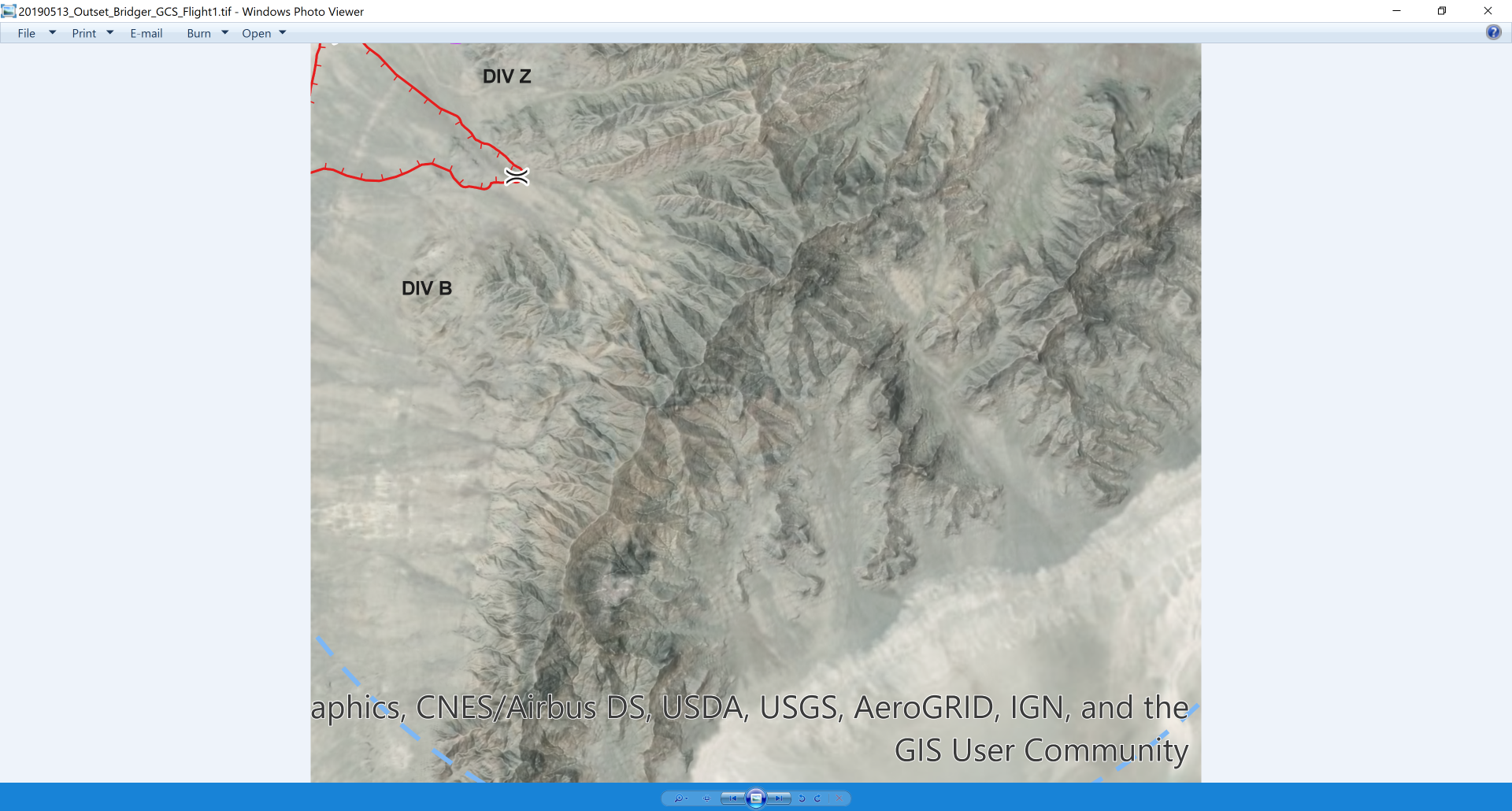

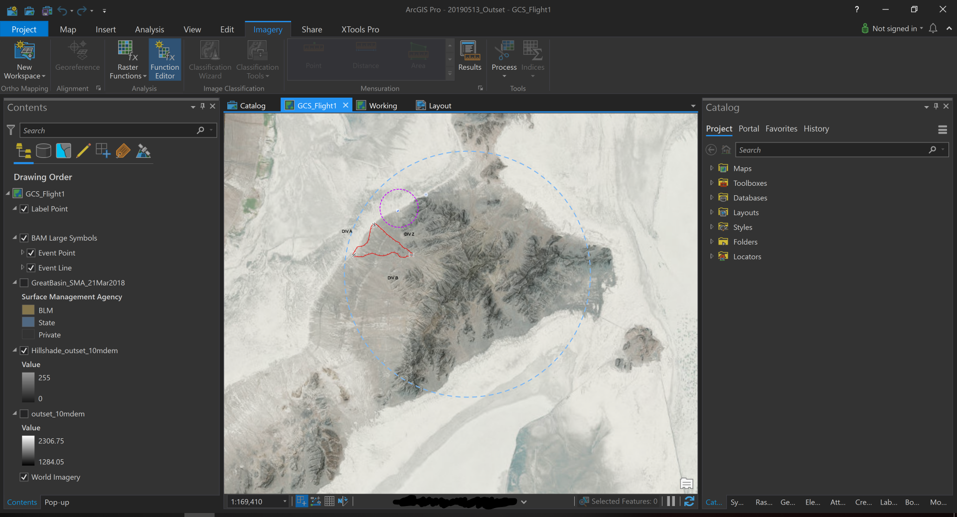

When exporting a .tif file in Data view of ArcGIS Pro (2.3.2), the extent of the map in data view is correct (Figure 1), but when exported, the file displays only half of my data view extent and is at a much larger scale (Figure 2). I suspect an incompatibility between my Windows 10 (1803), NVIDIA and Intel displays, as other issues with text manifests with programs such as Agisoft as well. I have the most current drivers for both displays.

Figure 1 - Data view
Figure 2 - Exported TIF
